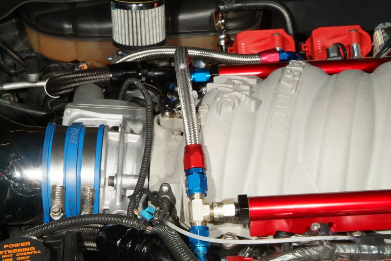

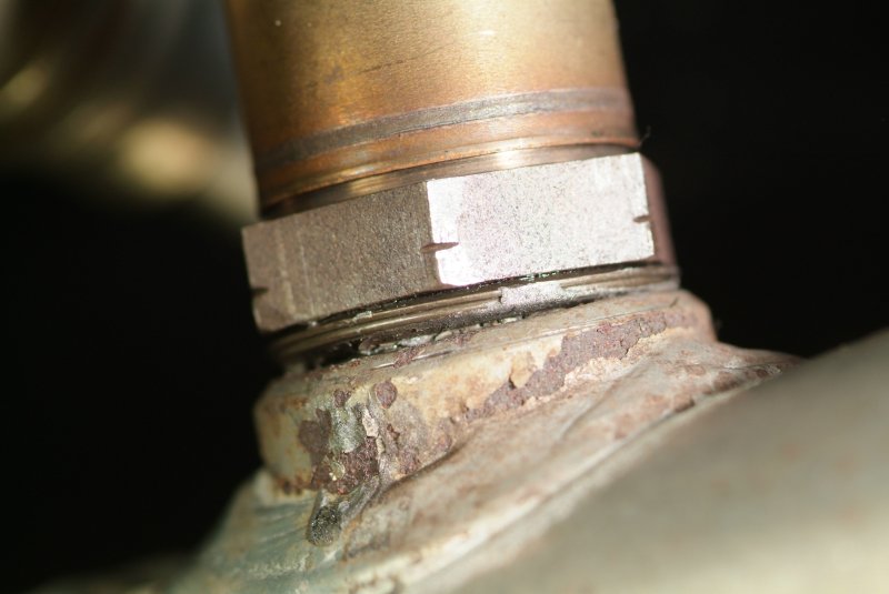

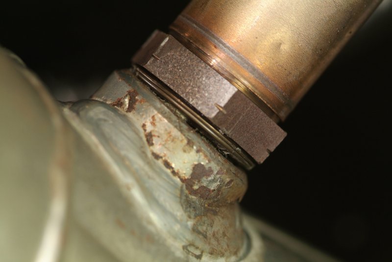

Yesterday I found that the clamps on the airbridge were loose, so I tightened them all down. Then when I looked at the hose clamps at the inlets to the intercooler, I saw this for the one on the passenger side:
http://www.corvetteflorida.com/pics/turbo_clamp_01.jpg
http://www.corvetteflorida.com/pics/turbo_clamp_02.jpg
http://www.corvetteflorida.com/pics/turbo_clamp_03.jpg
http://www.corvetteflorida.com/pics/turbo_clamp_04.jpg
Not only was it situated in such a way that the end of the threaded shaft was jammed against the radiator (and likely would eventually wear a hole in it from vibration), it was pretty much impossible to get a socket or wrench on that nut. I was afraid that the radiator would have to come out in order to correct that problem, but I was able to loosen up the pipe enough, and nudge the radiator over a bit to the left enough to get a Gearwrench 11m box wrench on the nut and tediously loosen up the nut enough so that I could move the clamp around to a better position.

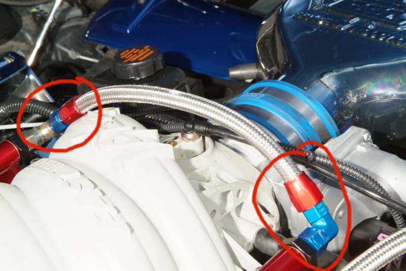

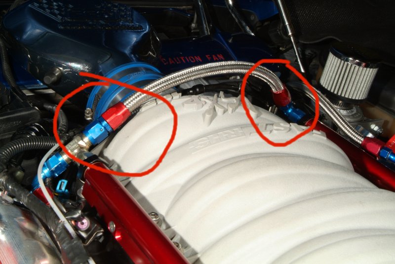

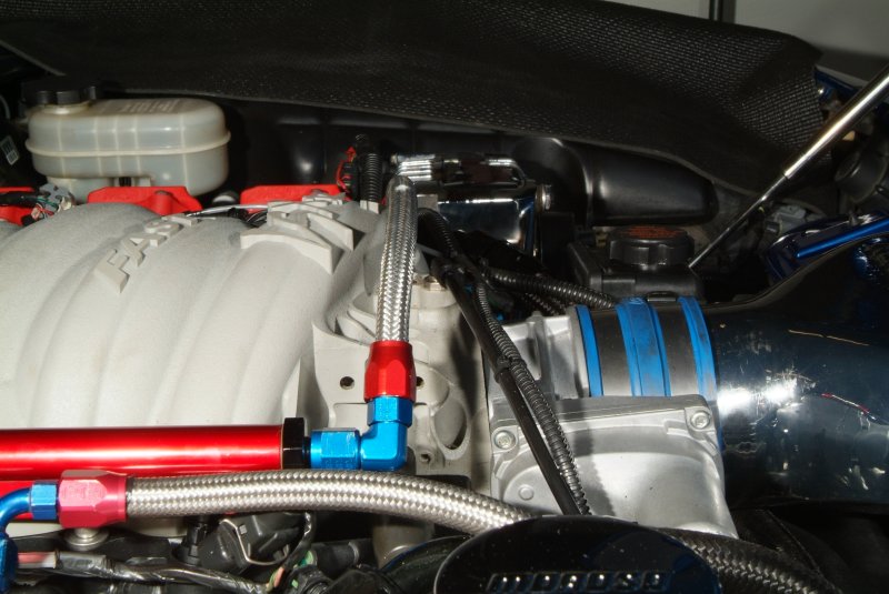

Then not really anything damaged or broken, just that I don't think the way the turbo oil supply lines were put back together was done the best way that they could have been.
http://www.corvetteflorida.com/pics/...ly_line_01.jpg
So I rearranged that a bit. Wasn't really comfortable with that AN fitting hanging down at an angle to maybe catch on something or get hit by something while driving.
http://www.corvetteflorida.com/pics/...ly_line_02.jpg
Easy matter to just loosen up the AN fitting and turn everything to fit where it needed to be. Also replaced the sheet metal screws that Chris Harwood put in those clamps with bolts and nuts to hold everything more securely. I guess I could have dressed it up better, since Harwood put it this way to mount that God awful external fuel pump he put up there. But maybe one day I'll work on it to make it look more aesthetically pleasing.

http://www.corvetteflorida.com/pics/oil_junction_06.jpg
This all should keep any of those connections from moving around from vibration and hopefully keep any future oil leaks from developing.

So I started up the car and lifted up. Then squirted the joints with soapy water and look for bubbles. Damn. Leaking like crazy. Looks like the tech didn't push the pipes together enough, because there are slots cut into one of each pipe end that slides over the mate in the slip joints. They look like this:
http://www.corvetteflorida.com/pics/...nverter_04.jpg
The slots are there so that the clamp can make a better seal with the clamping force applied by the clamp.
So what happens is if the inside pipe isn't shoved in far enough to go beyond the cut slots, exhaust escapes, goes right underneath the clamp holding the joint together, and there you have an exhaust leak. So if one is leaking at a joint, then ALL of them on that joint are leaking. So yeah, I suppose that the exhaust smell I have been smelling while driving the car is coming from those exhaust leaks right underneath the floor boards of the passenger cabin. And for a turbo powered car, so is a lot of the boost being generated just being pissed away through those leaks.
Great.... Probably a good chance the other joints downstream are leaking too, but I didn't bother checking them since I have to take that all apart anyway. I guess the tech just didn't check for exhaust leaks. :face_palm_02:
