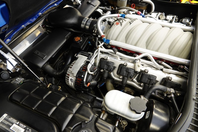

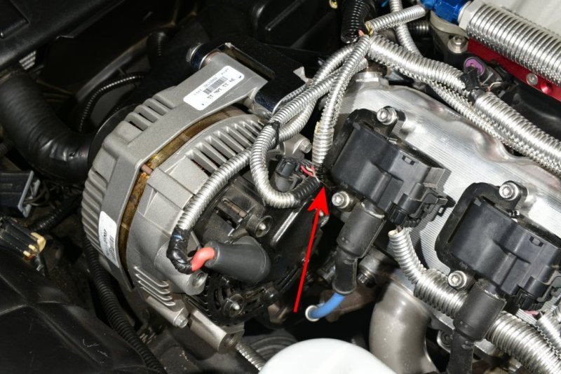

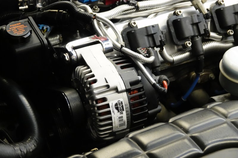

Only thing that is potentially going to be a wrinkle here (that I know of now, at least) is that the current alternator is very VERY close to the coil sitting above cylinder number 1 on the valve cover.
http://www.corvetteflorida.com/pics/...earance_01.jpg
http://www.corvetteflorida.com/pics/...earance_02.jpg
This COULD be an issue.
But hopefully the new alternator won't be too fat back there to fit where the old one is located. Really only one way to tell, I guess.

Yeah, I used to actually have a chrome plated alternator way back when, but it didn't last long. And the plating was pealing off of it. That is why I would prefer polished aluminum this time.
There might be a solution if I have a clearance problem, though. Back when Aaron Scott was working on my C5Z, he indicated he was having ignition problems and recommended that I replace the MSD 82858 coils I had on the engine with regular stock LS6 coils. Which I did. Because I trusted him at the time. But with hindsight now, perhaps those coils I have sitting in a box are perfectly fine. I looked them over today, and heck, somehow they sure got scuffed up on one side, so I have no idea what they have been through.
Anyway, I will attach photos below, but the place where there might be a clearance problem with the stock LS6 coils, might not be so with the MSD coils. Since I have both, I can certainly check that out when the alternator shows up. Replacing the coils isn't any big deal, so if the new alternator fits with the MSD coils, and the coils work fine, then problem solved.
So we will just have to see what happens.

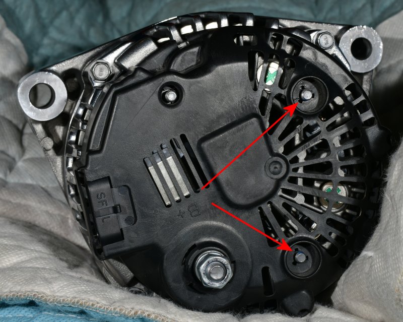

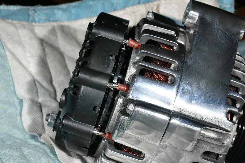

The next thing I noticed is that the plastic cap on the back of the alternator was loose. Well, the two threaded studs holding it in place didn't have the nuts installed that would have done that.
http://www.corvetteflorida.com/pics/tuff_stuff_02a.jpg
http://www.corvetteflorida.com/pics/tuff_stuff_02.jpg
Or maybe they it was held tight in place by crimping on the studs and rolling around in the box during shipment just loosened them up. Regardless, not a real good impression.

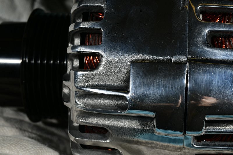

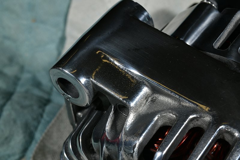

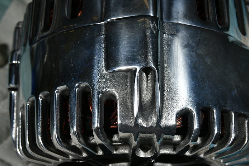

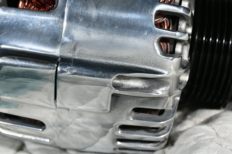

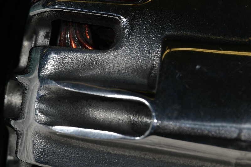

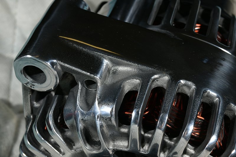

Well, the icing to this cake was when I started looking at the actual polishing job itself. Well, NOT impressed!
http://www.corvetteflorida.com/pics/tuff_stuff_09.jpg
http://www.corvetteflorida.com/pics/tuff_stuff_10.jpg
http://www.corvetteflorida.com/pics/tuff_stuff_12.jpg
http://www.corvetteflorida.com/pics/tuff_stuff_15.jpg
http://www.corvetteflorida.com/pics/tuff_stuff_16.jpg
http://www.corvetteflorida.com/pics/tuff_stuff_17.jpg

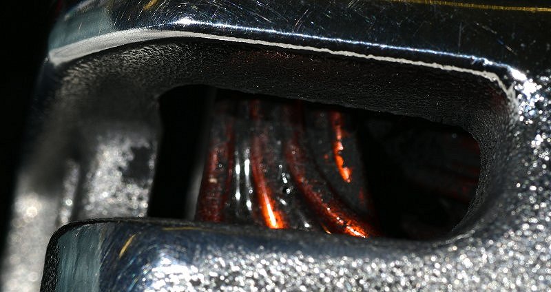

I also noticed that polishing compound appeared to still be in small nooks and crannies in the alternator housing, which meant that it was not cleaned off properly to remove the compound. If that wasn't quite enough, I also noticed what appeared to be polishing compound on the windings INSIDE of the alternator.
http://www.corvetteflorida.com/pics/tuff_stuff_11.jpg
Which to me indicated that this thing was NOT taken apart to be polished, and was polished as is as a completed unit. Well, heck, I could have done that myself if I wanted to ruin a perfectly good alternator by getting polishing compound all inside of it. Thanks, but NO thanks.
So I contacted Summit Racing, sent the above pics to them, and told them what I thought about this junk I was sent by Tuff Stuff. They immediately sent me a UPS return tag, and I have that alternator all boxed up to take to a drop off site tomorrow.
Heck, I didn't even try to see if it would fit on the engine. I just did not want to waste my time mounting it just to take if off again to pack up to ship out of here. Maybe I should have done that, but honestly, I was pretty pissed off by then.

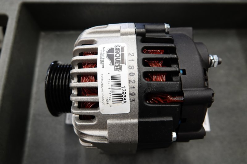

So I just ordered a plain jane "limited lifetime" warranty alternator from Advance Auto. Maybe one of these days I'll try my hand at taking apart one of the old alternators I believe I have laying around here, and see about rebuilding it. While it is apart, I can do my own polishing if I feel real ambitious. I certainly couldn't do an worse than what I am seeing from Tuff Stuff.

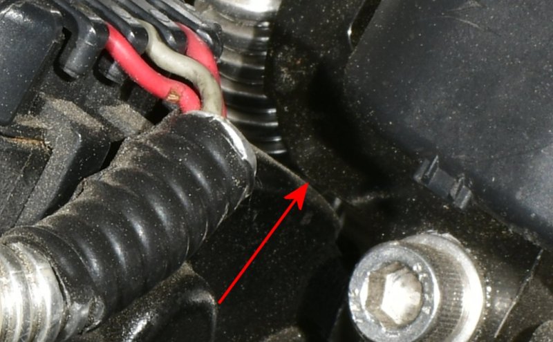

in the 2nd picture of your first post, does the red wire have a bare spot? also, when my alternator went out, i got one from autozone. immediately got the charging system fault. alternator worked. problem is the valeo alternator the corvette comes with ignites at 1600 rpms. the ones you get aftermarket ignite at 2200 rpms. so don't lose your oem alternator. ended up getting mine fixed at a local alternator/starter repair shop here.
Yes, I noticed that too when I looked at the pictures. Not sure when nor how that happened. I'm intending on dabbing a bit of Plastidip on it when I replace the alternator. Which reminds me, I wanted to order some white and red Plastidip. I have black and white (spray only), but no red no white in the "dipping" variety.
