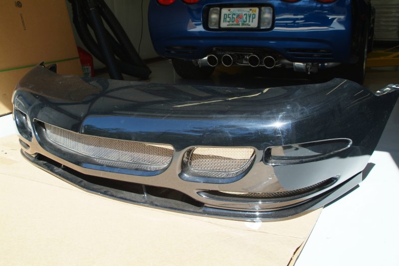

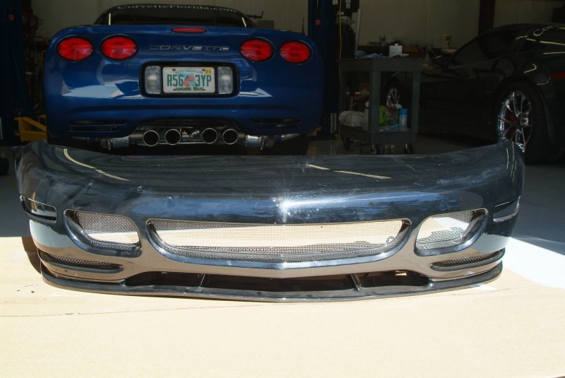

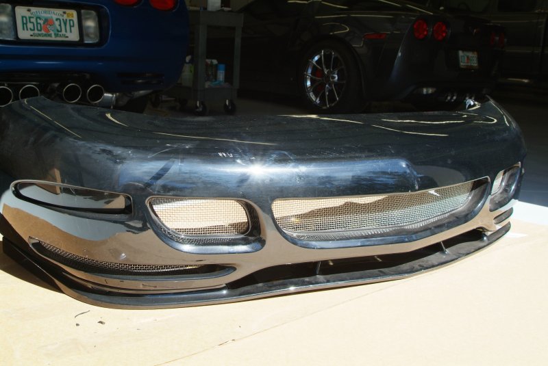

Well the Tiger Shark bumper I got off of Ebay came in today. Really doesn't look in too bad of shape at all.
http://www.corvetteflorida.com/pics/..._bumper_01.jpg
http://www.corvetteflorida.com/pics/..._bumper_02.jpg
http://www.corvetteflorida.com/pics/..._bumper_03.jpg

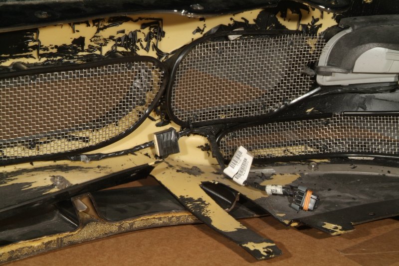

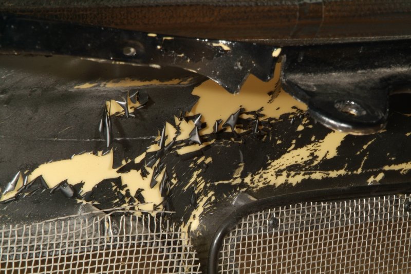

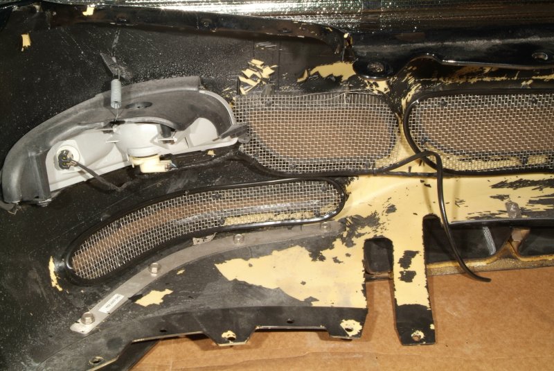

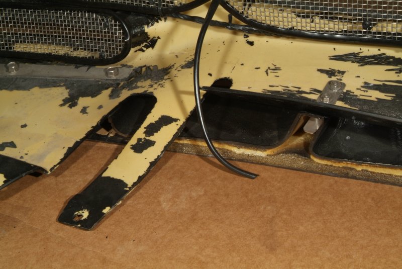

No cracks that i can see, and all the mounting tabs look OK. But even if my C5Z were black, it would probably need to be repainted anyway.

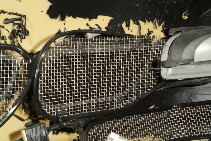

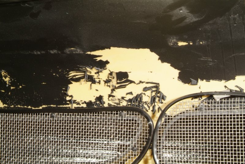

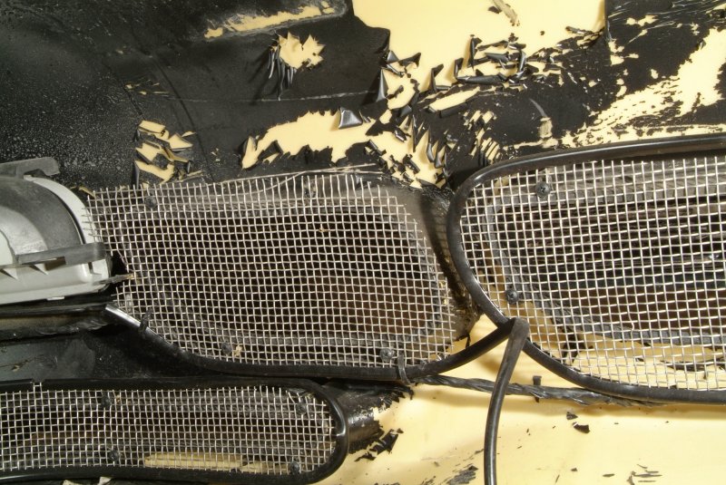

But looking from it from the back, obviously the paint applied there wasn't meant to last long at all, as it is curling up and flaking off.

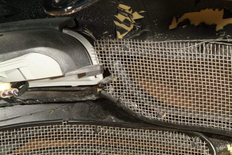

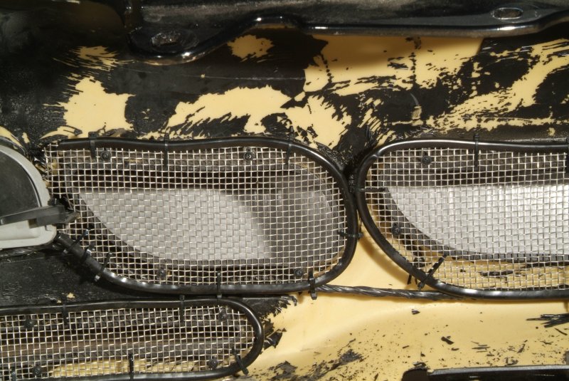

And it looks like I'm going to have to fix some of those screens, particularly the rubber molding around the edges of them.

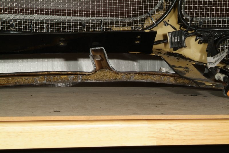

Looks like the splitter, if I decide to put it on the car, is going to need to be fixed too. Looks like it might have gotten pushed up a bit on the passenger side, as it appears bowed in the pictures at the beginning of this thread.

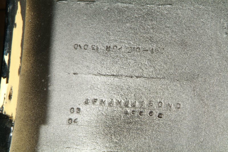

I'm trying to figure out who manufactured this bumper, but this is the only sort of identifying number or any sort I can see on it.

Hi,I also bought a used tigershark ,the same one that you bought.In fact the paint was pealing off the back.
I use a compresser with a air gun.It removed 80% of the pealing paint.Then I used scotch bright pads to scrub off the rest.A orbital sander will go threw it very easily.
If you don't want to have a disaster when you paint the bumper be sure to sand off all the paint and primer as it is most likely the same crap as on the back.
Then prim it .with bumper primer.

BTW, I contacted Starcraft and asked them if they could identify the bumper for me from the pics I took. Here's the reply I got.
On 3/7/2013 4:05 PM, Cheryl Pauff wrote:
> Rich,
> Yes this does appear to be a genuine Tiger Shark front fascia. It was
> manufactured in Troy Michigan.
> Thank you,
> Cheryl Pauff
> Starcraft Distribution
> 28255 Charlotte Ave Bldg 1
> Elkhart IN 46517
> (574) 970-5597
> www.starcraftparts.com

The black rubber molding around the screens was tougher to work with than I thought it would be. It's very rigid plastic, not rubber at all, and the slit for the screen to go into is razor thin and tight. I had to use a thin flat bladed screw driver to pry the edges open while trying to shove the screen in one wire at a time. Meanwhile the wire is pretty darn sharp, so I got jabbed a few times in the process. All in all this was a bugger to work on. I would imagine trying to do this with the bumper still on the car would have been pretty much impossible to do. Having it sitting on my workbench was tough enough doing it. I wire tired the moldings to the screen, so hopefully I won't have to do this job ever again.

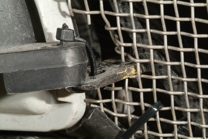

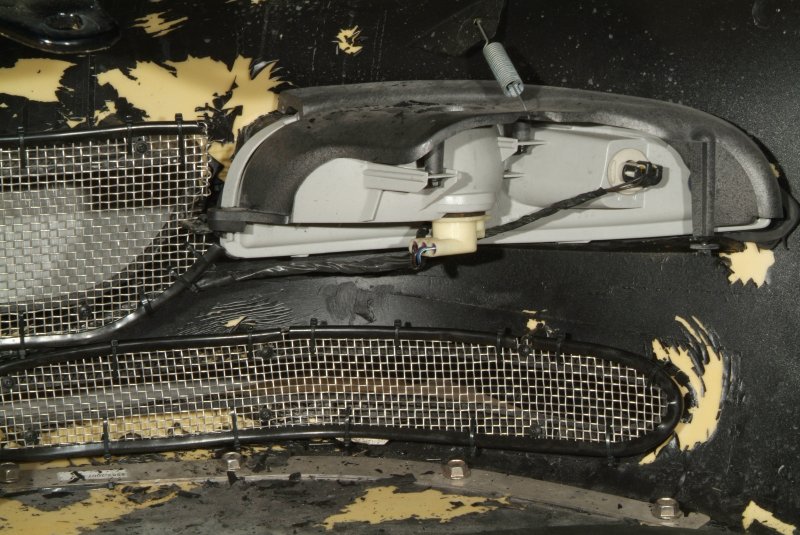

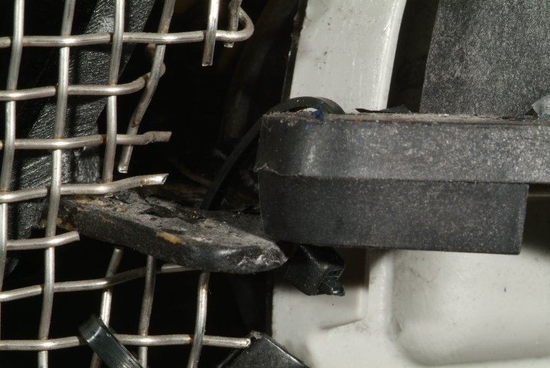

Also found that the front of the turn signal lamps weren't bolted into the mounts for them at all. The mounting holes on the lamps don't reach the tabs on the bumper, so I just wire tied them in place. Maybe whoever I get to do the mounting and painting of the bumper can fix that for me.
The black paint on the inside was just falling off while I was working on those screens, so I guess it won't be very tough at all getting it all off. If I felt like cranking up the pressure washer it would probably make short work of getting that crap off.

Try using a heat gun on that molding Rich. Just don't get it too hot.
Rich Z 03-08-2013 11:48 PM
Yeah, I thought maybe heat would make it more pliable, but then I couldn't see how you would be able to handle that hot plastic. It's too fine of work to use gloves with.
Well, it's done now anyway. But thanks for the suggestion.

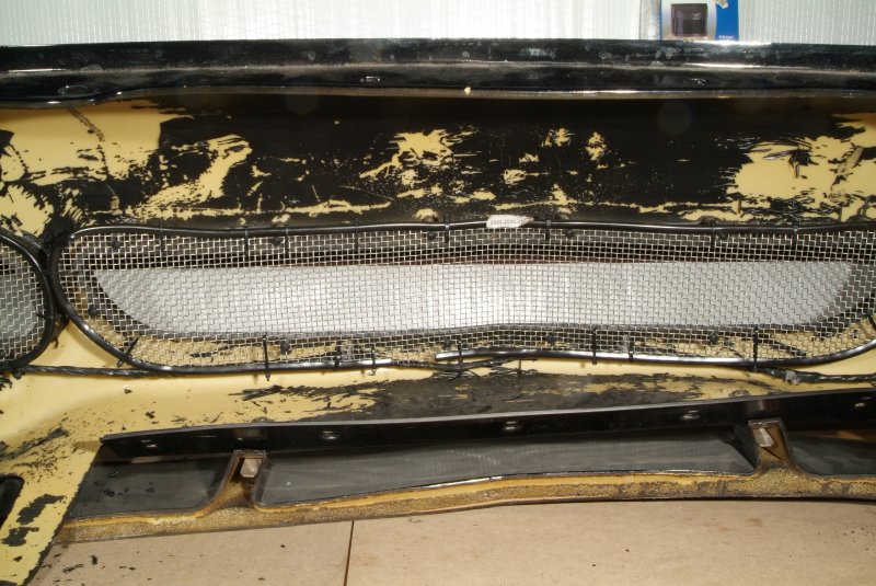

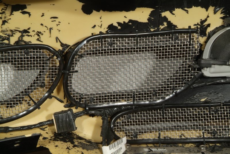

Kind of looks funky from the back with all the wire ties, but hopefully it will hold those moldings onto the screens so they don't come loose again.

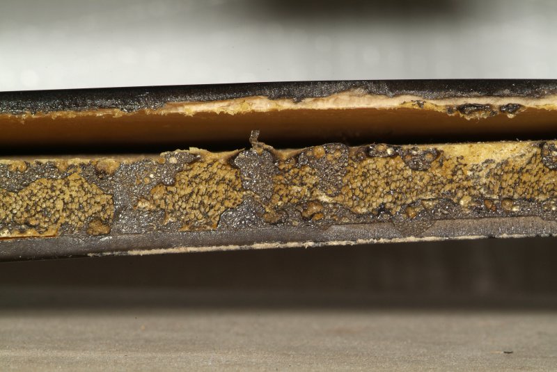

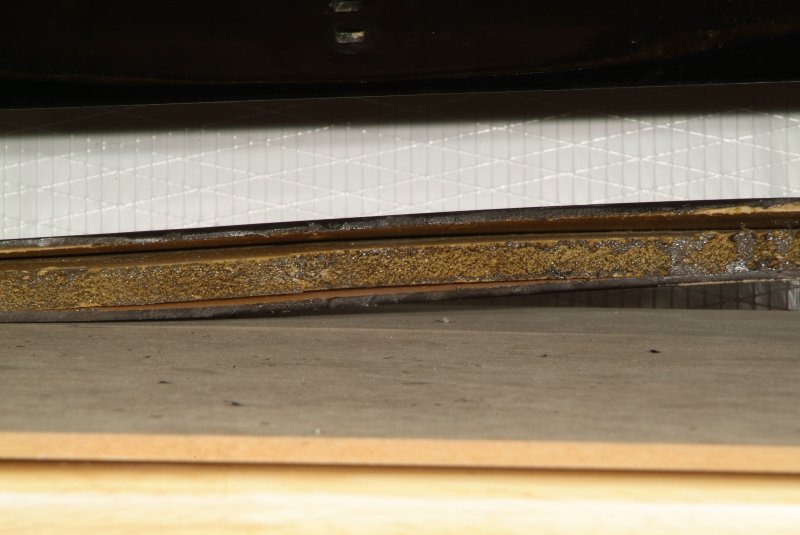

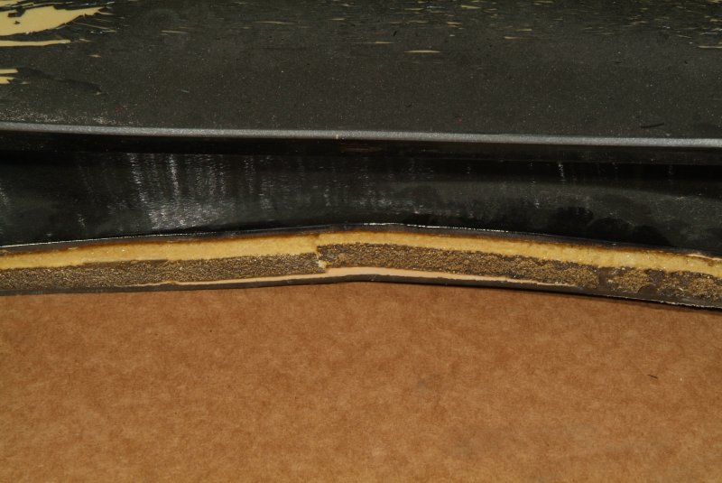

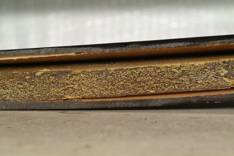

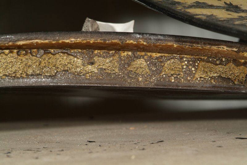

The splitter is pretty messed up. It's definitely warped on the passenger side. And the urethane has separated from the foam core on that side as well.

Then I had to wire wrap the fronts of both of the side turn signal lights to the tab on the bumper, since they don't mate up properly. Not sure of what sort of permanent fix could be done.

2 suggestions.......first, go around the edges of the wire/plastic molding with some
black RTV sealant. That will probably eliminate the need for ZIP ties. Second,
maybe a "U-BOLT" of the proper size with a piece of flat metal on top to use
on the front of the turn signal lights. :shrug01:

2 suggestions.......first, go around the edges of the wire/plastic molding with some black RTV sealant. That will probably eliminate the need for ZIP ties.
Heck, those moldings are pretty tight as they are on the screens, but they are also stiff enough that I'm afraid they might come loose just because they are being forced around those curves. Especially when they are pulled off to paint the bumper itself. I had originally thought of putting some sort of adhesive into the molding itself and then put the screens into them to hold them together, but they really are a bugger bear to work with. So I would be playing beat the clock to try to get the screens in before the sealant hardened up on me. I don't think the wire ties are going to be visible from the front at all, so this will probably be fine for me.
Originally Posted by navy2kcoupe (Post 173599)
Second, maybe a "U-BOLT" of the proper size with a piece of flat metal on top to use on the front of the turn signal lights. :shrug01:
Yeah, I can visualize what you mean. I could probably fabricate something myself on the milling machine. Thanks for the idea. I'm thinking I might need to just pull those lamp assemblies out and LOOK at them. Might be a fixable reason why those mounting holes aren't lining up properly.

Been working on the paint job on the hood of the C5Z lately, so this bumper is mostly just on the back burner right now. But it is taking up a good chunk of real estate on my work bench. I need to figure out if I will have to get the whole car painted, or if I'll be able to squeeze a couple more years out of the current paint job before really needing to do that. If that works out hopefully I can get someone to do a real good color match when painting and installing that tiger shark for me. I'm also hoping they can fix that front splitter too. I'd be tempted to try gluing it back together myself, but I'm afraid I might just make matters worse by not knowing what the hell I am doing. Does urethane become more pliable when heated so I could bend it back in shape? And how close is the bendable stage of heating to the MELTING stage? :ack2:
If I ruin this one, it's going to probably be pretty darn tough to find a replacement.
Heck, maybe when mounted that will pull the shape back the way it should be enough so that it doesn't matter. :shrug01:
