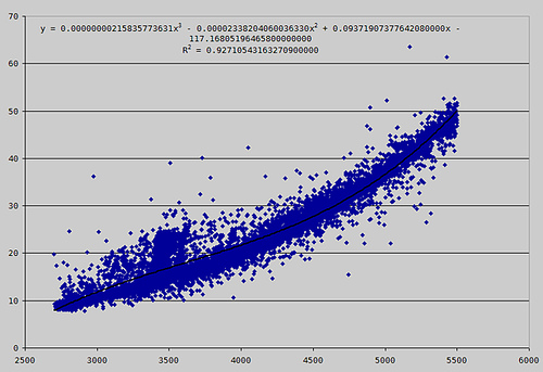

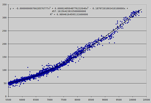

To farther prove my point about the MAF having very different characteristics on low vs. high airflow situations, let me demonstrate a typical spread of samples from < 5000Hz, and above 6000Hz.
http://www.corvetteflorida.com/pics/MAF_scatter_low.jpg
http://www.corvetteflorida.com/pics/...atter_high.jpg
As you can notice, the scatter is quite significantly higher in the lower frequency areas (look at R^2 values). I use different sets of parameters to filter out noise for these two distinct regions, because of their different characteristics, I use 5500Hz as the usual boundary between high and low noise areas. I had a very large smile on my face, when I downloaded LS2 and LS7 stock tunes, and saw not one, but two MAF tables, switching at 5800Hz! Apparently GM also has two different sets of filtering parameters for the two distinct characteristics of MAF and the signal quality based on airflow.
