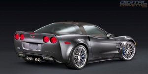

Other pics released on the ZR1...
we know the HP to be hovering around 650. The price? Word on the street is 100k. A member of the Cape Kennedy Corvette Clube has his order in and it has been accepted. He will be 'trained' at the factory and must have been a previous Corvette owner...as I recall his story to me. I think he dropped $99,900 and is hoping for a serial number under 10 (of 1500 to be produced).
As far as the car goes...check out those coves!
Another cool feature is the hood modification that shows off that radical LS9 powerplant!
