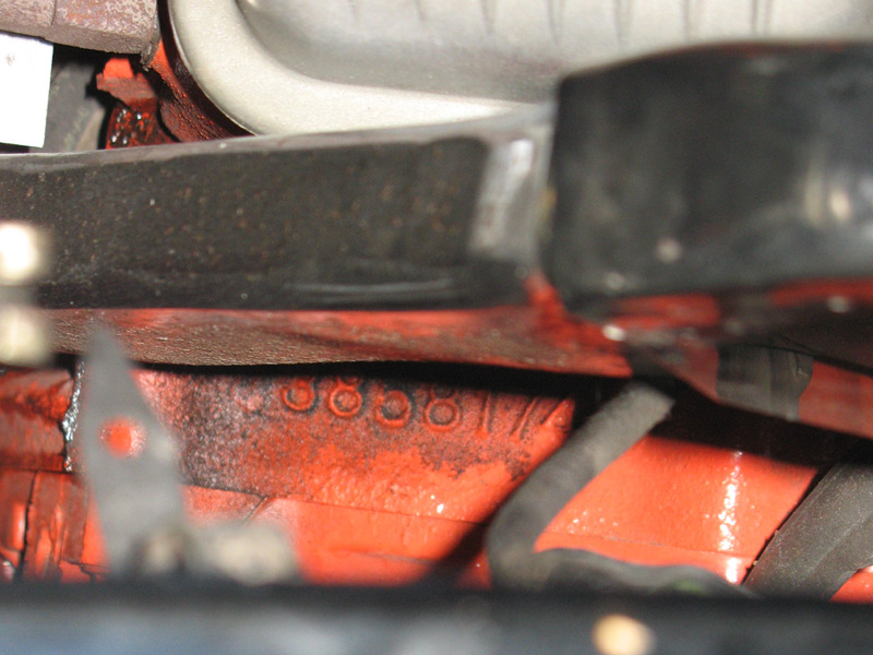

The casting number is a sequence consisting of raised numbers that was cast into the engine block when it was made. What's a bit tricky here is that casting numbers on Corvette blocks can also be found on other engine blocks made by GM. Casting Numbers are important to the engine documentation process because certain numbers were used for Corvettes and some were not. Also, the numbers are specific to the size of engine in the Corvette. 283's, 327's and 427's all had their own casting numbers specific to individual years, so for the process of documenting a Corvette engine, the casting number will be used to confirm that that block was used in a Corvette and that it was available during the same year the Corvette was manufactured, and finally, it was unique to a specific engine size. The casting number on Chevy V8's is located on the drivers side of the engine where the block is connected to the bellhousing. It can be a bit hard to see with the ignition shielding in place but the numbers are fairly large. The casting number on my 1966 is 3858174 which is identified as a 327 ci V8 block. That block casting number was also used in 1964-67 passenger cars including the Chevelle and Camaro as well as Chevrolet trucks. Casting Dates

Casting NumbersThe casting number is a sequence consisting of raised numbers that was cast into the engine block when it was made. What's a bit tricky here is that casting numbers on Corvette blocks can also be found on other engine blocks made by GM. Casting Numbers are important to the engine documentation process because certain numbers were used for Corvettes and some were not. Also, the numbers are specific to the size of engine in the Corvette. 283's, 327's and 427's all had their own casting numbers specific to individual years, so for the process of documenting a Corvette engine, the casting number will be used to confirm that that block was used in a Corvette and that it was available during the same year the Corvette was manufactured, and finally, it was unique to a specific engine size. The casting number on Chevy V8's is located on the drivers side of the engine where the block is connected to the bellhousing. It can be a bit hard to see with the ignition shielding in place but the numbers are fairly large. The casting number on my 1966 is 3858174 which is identified as a 327 ci V8 block. That block casting number was also used in 1964-67 passenger cars including the Chevelle and Camaro as well as Chevrolet trucks. Casting Dates
