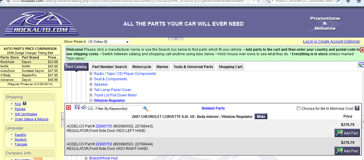

Ive replaced sever window regulators and motor assembly on the c3-and c4 corvettes but not the c5, the one thing Id strongly suggest is doing as much research on the process as you can before stating and buy a complete regulator with the motor attached

Ive replaced several window regulators and motor assembly on the c3-and c4 corvettes but not the c5, the one thing Id strongly suggest is doing as much research on the process as you can before stating and buy a complete regulator with the motor attached
http://www.rockauto.com/catalog/x,ca...parttype,10217
