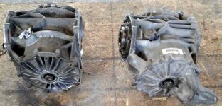

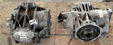

Trying to find some information out before tackling this.
C6 production 08/04
Entire rear suspension with 3.42 diff
I know about the weak case issue
I know the transmission were the same for 05 and c5, so the diff will bolt directly to the transmission.
Biggest question is about the wheelbase added length of 1.2" for the 2005 year did it move the diff back as well?

found these offset mounts for 550.00 from rkt performance. way too much money for that. looking to fab some up with a friend of mine.

found out lgmotorsports makes solid mount. so i'll be making some out of square tube steel and weld bolts to it. i can put a 1/4" rubber mat material i have to reduce vibration.

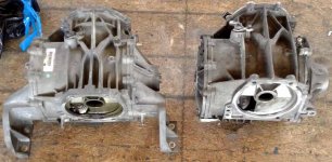

I'm bored so I cut the factory diff mount open. Liquid filled with a baffling system
