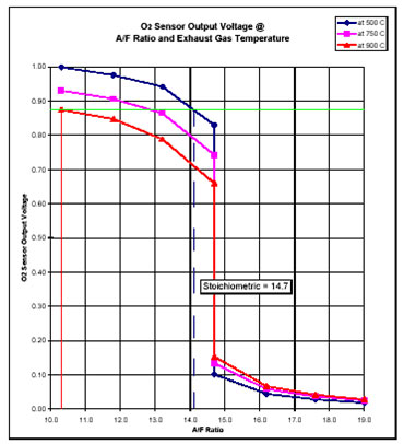

The output voltage of a NBO2 sensor changes slightly (higher) the richer the gas is. Many people believe, that by calibrating this curve and linearizing it, one can make a cheap AFR meter using a NBO2 sensor. This does not work. Look at the following curve. This curve was not actually measured but calculated from the material constants and appropriate equations governing NBO2 sensors. In the real world the NBO2 output signal looks pretty close to this curve.
The green line in the graph is at about 880 mV. Because the offset of the curve changes with EGT, at 900C the 880mV output would mean about 10.3 AFR. At 500C the same voltage means 14.1 AFR. So without knowing precisely the sensor head temperature, there is no way of relating the output voltage to a specific AFR. An output voltage above 450 mV just means richer than 14.7, below means leaner. The numbers on a NBO2 meter are just paint. The only correct one is 14.7.
Because of these characteristics ECU's with NBO2 sensors use the sensor only during cruise and idle. They operate by checking if the voltage is below 0.45V, richen up until it is above 0.45V, then lean out, then richen up again and so on. Therefore the mixture oscillates around 14.7AFR. This AFR is optimum for minimum emissions. The oscillations are caused by the operation of the ECU, not by the sensor as many people believe. At WOT, as mentioned before, the engine wants a richer mixture to make power. Because the NBO2 output cannot be used there, all ECU's (not WBO2 based) will ignore the NBO2 signal and purely meter fuel by pre-stored maps relating TPS, MAP/MAF and IAT. There are products that claim to modify/replace the signal of one or more NBO2 sensors at WOT or boost to richen up the mixture. These products can't work because of the simple fact that ALL NBO2 based ECU's just ignore the signal at boost/WOT.

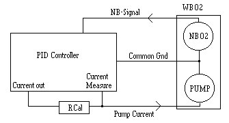

A basic diagram of a WBO2 controller is shown below:
The PID part in the WB controller regulates the pump current based on the NB-Signal, trying to hold it at a steady 0.45 Volts by varying the pump current. PID stands for Proportional/Integral/Differential and is a commonly used method for a feedback regulation system. Because of manufacturing tolerances the pump current can't be used directly as AFR measurement. For the same AFR different sensors require different currents. Therefore every sensor has built into its connector a calibration resistor called RCal in the diagram. The voltage drop over this resistor is actually measured by the controller (V = I*R). The sensor manufacturers trim this resistor during the manufacturing process so that the controller sees the same voltage drop for a given AFR.
This is how analog WB meters work. They are called analog because the input/output signals of the controller are smoothly varying voltages/currents. The PID controller can be implemented in a microprocessor or as analog electronic circuit using amplifiers, transistors and so on. Implementing it in a microcontroller does not make it a digital system.
