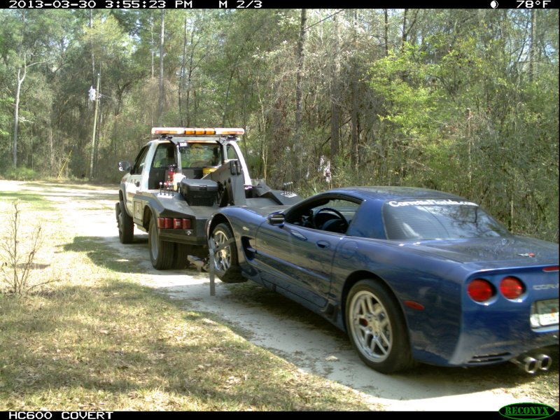

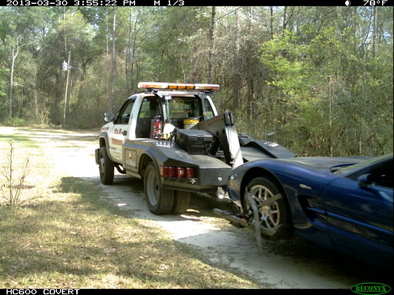

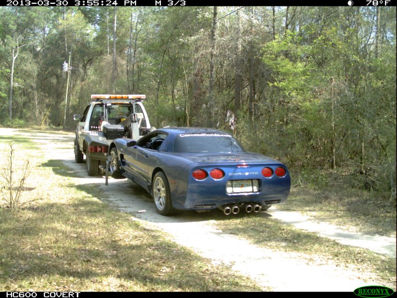

Anyway, this smaller tow truck extended a "T" to the front wheels parallel to the ground and right at ground level, and that cleared the front end with about a half inch to spare. Darn lucky I've never lowered the car, otherwise it would have scraped the hell out of the underside of the front bumper fascia. So he got the front tires locked down on the carriage and lifted the front end but not so much that the turbos were in danger of scraping on the road because of the steep angle. And he took his time driving so the car wouldn't bounce around much and we were able to get the car back home without any damage.

A solution that was used to get my car on a flat bed truck was this. Like you they were afraid the back might drag when the front went onto the flat bed. What they did was to put some 2x4 between the front and back wheels so that when they pulled the front onto the bed the back wheels were lifted up onto the 2x4. In my case the 2x4 pieces were short and so when the car was on one they took the one in back away so it would not touch the car.
I also had a tow were they used a regular truck to lift the front and gently pull my car home.

Well, wish I knew what this particular type of tow truck was called so I would be able to specify it by name next time one of the cars breaks down...

Looking at the pictures of the car on the tow truck one thing empresses me. The tow truck is well maintained and not all cluttered up with junk on the deck of the truck. Yet the truck looks to be at least a few years old. I would guess he is a lot like you when it comes to being professional in how he takes care of his equipment. I would say you were extremely lucky to find someone like that to help you out of a bad situation.

I've had to get a tow three to many times over the years. I use the AAA tow company in Venice, Flagship Towing. They have always used 2x6's to lessen the angle on to the roll out bed and also to roll the rear wheels up on when getting my lowered Vette up and down. My front spoiler does drag but my facia has never been damaged.

that type of truck uses an "Eagle Claw" style lift. they are real popular with the repo crowd due to being able to back up to a car, even at a 90* angle (like if a car is parallel parked between 2 other vehicles) to the front wheels and pick up the front end all while staying seated in the truck. they can slowly get the vehicle off of the private property they got the car from and onto public property and then safely and legally attach the wheels to the boom/lift.
